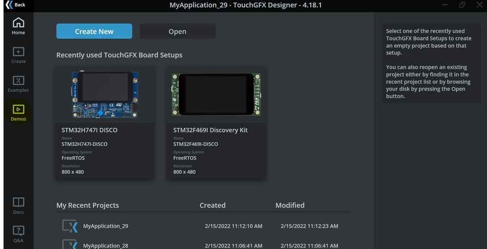

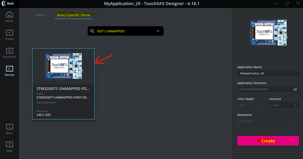

You can find the example in TouchGFX Designer.
1) Open TouchGFX Designer and click on "Demos" panel at the left
2) Click on "Board Specific Demo" at the top and type "G071 UNMAPPED" in the input box.
You will be suggested the example you need. Click on it, and click Create at bottom right.
0693W00000JPqeYQAT.png3) Enjoy :)
