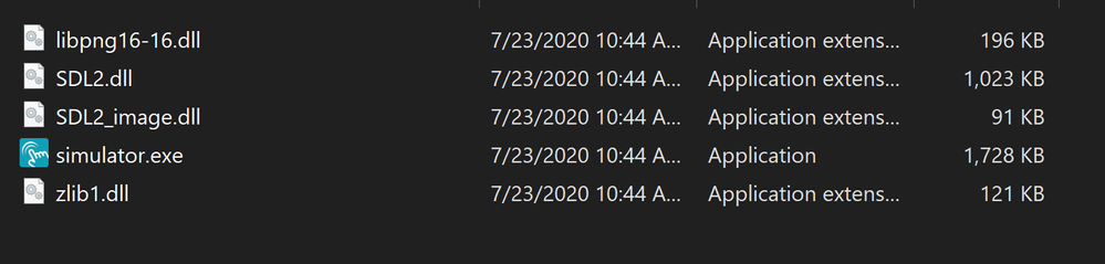

2020-07-31 4:54 AM
To do so, just archive the entire folder bin in ./build/bin. The .dll files are necessary for the simulator.exe file to run correctly. Then people can retrieve the archive and double-click on the simulator.exe.
Here is how it looks like :
