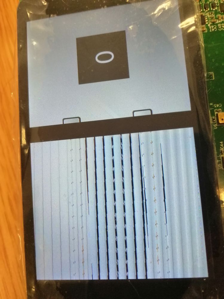

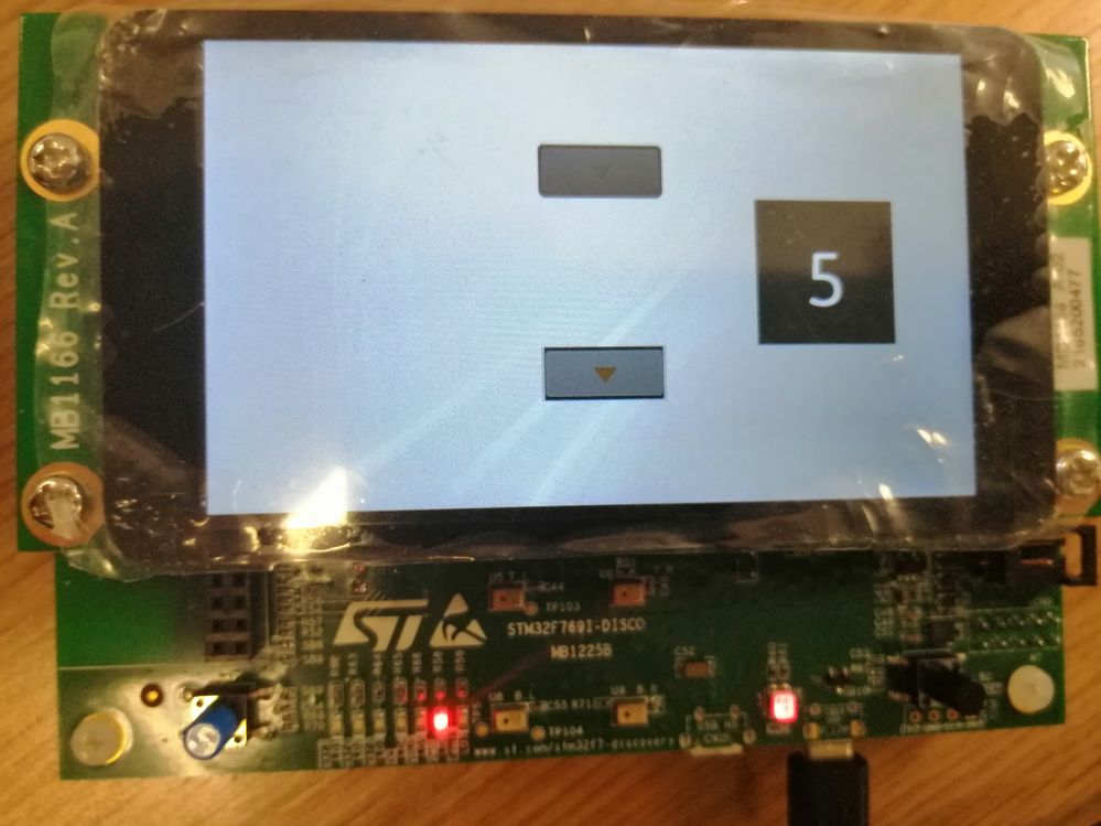

When debugging on GFX Designer , the display in the start shows up with some errors but when I press the display button it stars working as shown on the simulator.
after generating the code and moving to IAR, the following warnings were displayed:
The controller shows an inconstant behavior:

2019-11-17 5:01 AM
I have exactly the same thing with touchGFX "Run target"
Why first screen is corrupted and works after a screen update ?
