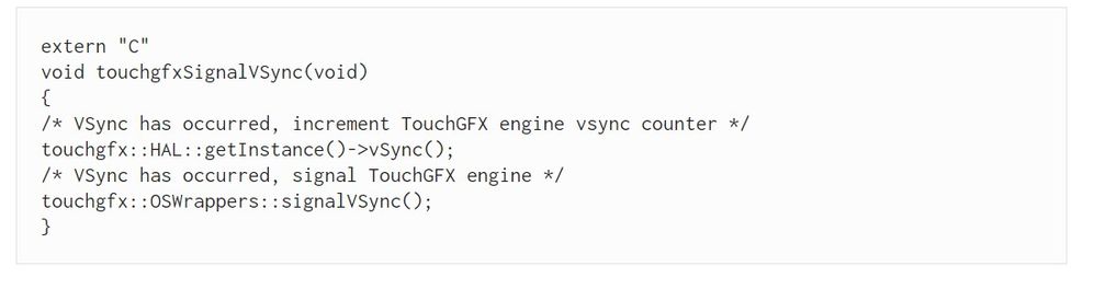

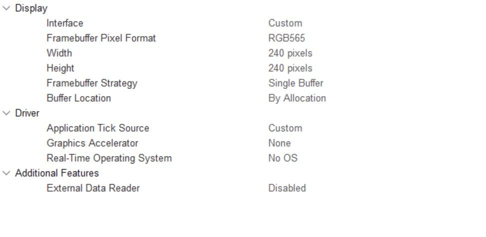

Hi, thanks a lot for your tips. I looked at the site https://helentronica.com/2021/01/22/touchgfx-on-a-custom-made-low-cost-board-with-the-ili9341-controller-over-spi/ , I use the STM32F429I-DISCO board, then selected touchgfx as software pack here in CubeMX and then made the appropriate settings for my extern SPI display (240x240 pixels) with the St7789. On the above mentioned page it says that in the TouchGFXGeneratedHAL.cpp the following function is defined: But in my project the function is not defined in the mentioned file. Since this is in the read-only zone, I can't just paste it in, have I defined something wrong or forgotten something? Do I have to change a setting in CubeMX for this?

If it is not defined in TouchGFXHALGenerated.cpp, you can set it in TouchGFXHAL.cpp which will not be overwritten by CubeMX. It doesnt seem like you set something wrong, what version of TouchGFX are you using ?

2021-03-22 3:49 AM
Actually no you have not set it correctly. The guide uses the Partial framebuffer strategy and not the single framebuffer strategy as you can see in the screenshot of the CubeMX configuration you shared.

Hi, maybe you can help me again. The following I have inserted the various code parts and made the appropriate settings. CubeMX writes the call from the function "MX_TouchGFX_Process();" in the while(1) of the int main, if I do not want to use an OS. In a timer interrupt every 30ms the function "touchgfxSignalVSync();" is called like in the example from yesterday(https://helentronica.com/2021/01/22/touchgfx-on-a-custom-made-low-cost-board-with-the-ili9341-controller-over-spi/), only the program never goes in there, I put a breakpoint in the call of the timer interrupt, but during the debug session the program stays in the while(1) in the function call "MX_TouchGFX_Process();". The timer interrupt is selected in CubeMX. Do you have any idea what could be the problem? I have created a screen with a white box and a button in TouchGFX, at least this should be shown by the display or do I need an external event for this?
