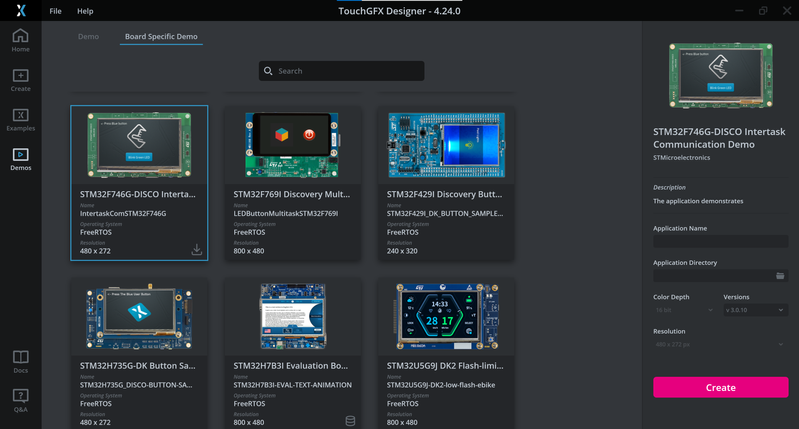

In addition, you can take a look at the available Board Specific Demo for STM32F746G-Disco that exactly demonstrates how to achieve the functionality you are looking for.STM32F746G-Disco Board Specific Demo

I tested out the demo on my board and it does work with the blue button and the green led on the board! Thank you for pointing it out to me. I think I will mostly be using the UI event to Backend part of this demo for now.

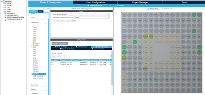

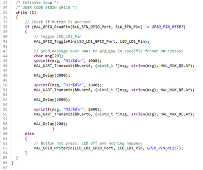

I have enabled UART6 on the board and I have tested a program out that sends a message to my arduino Nano board thats connected serially. It sends the message when the BLU_BTN is pressed on the board. This did work so the UART is at least transmitting correctly.

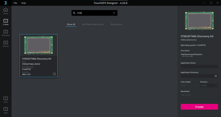

To enable TouchGFX code generation for your project, you need to follow instruction at Enabling TouchGFX Generator, but since you don't have a custom boards, it would be much easier for you if you just use the available TouchGFX Board Setup (TBS) to develop your project. This project has already configured all the required settings for developing your GUI. You just need to enable UART6 again.
TBS for STM32F746G Disco

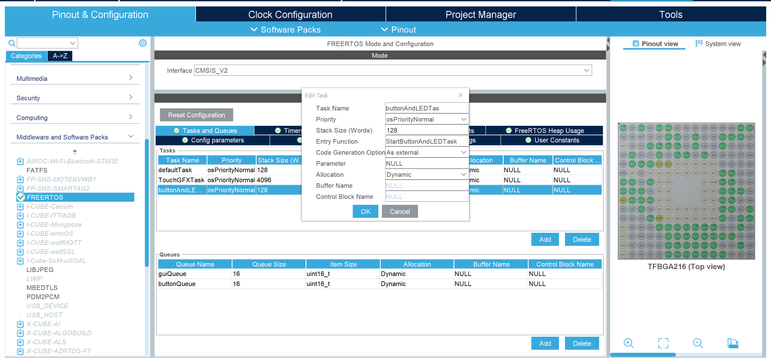

In the STM32CubeMX project, Middleware and Software Packs -> FREERTOS -> Tasks and Queues you can see that one task named StartButtonAndLEDTask is defined, and its "Code Generation Option" is set to "As external" which means the definition of the task is in another file and that file is main_user.c for the demo.

In addition, two queues are defined one for messages related to the LED and the other related to the Blue Button (Obviously, you don't need two queues if you are only dealing with one type of message). We can access them by the structs that are generated by in main.c (guiQueueHandle and buttonQueueHandle), and using FreeRTOS functions for handling queues.

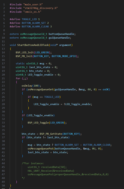

So, in main_user.c, we first set up the LED and the button, and then, we read the messages regarding the state of the green LED (because it is controlled from the GUI), and send the state of the Blue button to the GUI. Here you can do the same for instance reading from the UART and sending the received data to the queue.
main_user.c
