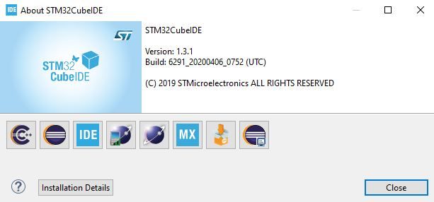

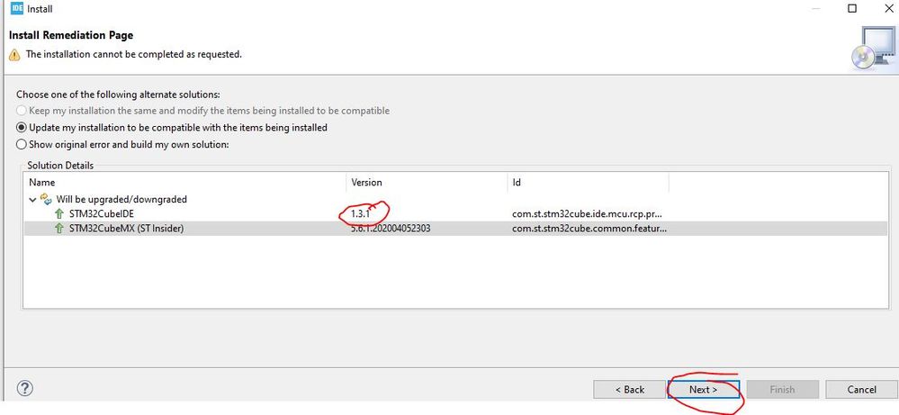

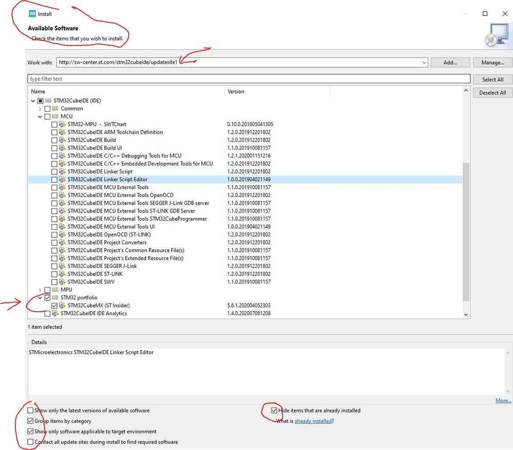

2020-07-27 12:07 PM
STMCubeIDE 1.3.1 is not available as an installer because minor release. Only 1.3.0 is available then let's rely on Help > Install New Software (native Eclipse one not ST's one) to get 1.3.1 upgrade.
Not sure smartest way but at least working on myside. Rely on update site url you can find Thanks "Manage" button.
Step1 ->
Step2 ->
Finally 1.3.1 is available ->

2020-07-27 2:01 PM
Thank you for your answers, I will try this tomorrow and let you know !
2020-07-27 11:54 PM
@Cartu38 OpenDev , you just saved my life ! Okay, maybe not my life but the life of this project !
If I have time, I will try to move my project to the last version of CubeIDE, but for the moment, I will stay with this 1.3.1 version.
Thanks you very much !
