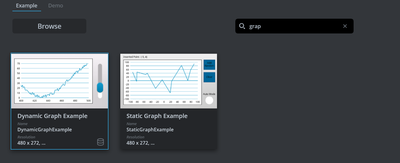

You can look at the dynamic graph example :
When the slider changes, we call setGraphRangeY() to change the y scale.
For your case, you should check the new value added and see if it is within your Y range or not before calling setGraphRangeY().
