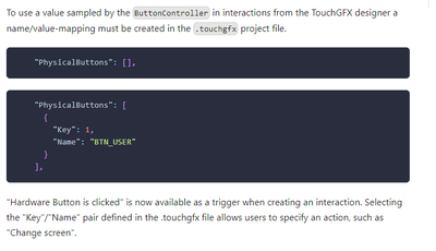

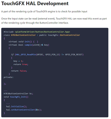

I am trying to follow this:
https://support.touchgfx.com/docs/development/scenarios/example-gpio
I am unsure where this code should be added:
I have modified this:
Everything compiles but whilst the LED toggles and the BTN_USER is selectable in the TouchGFX designer interactions drop down, the interaction doesn't get triggered. I am a bit stumped.

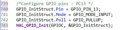

Can you show me a picture of your CubeMx GPIO setup ?
And are you using CubeIDE ?
Regards,
2024-02-16 12:33 AM
Sure, using CubeMX and CubeIDE
I have tried triggering it with an interrupt as well and again I toggle the LED but not trigger the interaction in TouchGFX. I just feel I am missing a step!
The GPIO setup
2024-02-16 2:39 AM
In CubeMX Try to set your PC13 to pull-up instead,

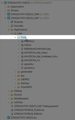

Then go to CubeIDE, and in "STM32H747I-DISCO_CM7/Application/User/Core" do New->File :
Name the new file "MyButtonController.cpp" (Give it the name you want, they called it "H783ButtonController" in the tutorial), edit that file :

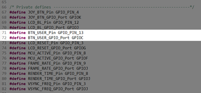

Here "HAL_GPIO_ReadPin" has "BTN_USER_GPIO_PORT" and "BTN_USER_PIN" in its function parameter.
These two variables are defined when you add label to your GPIO and generate the code in CubeMX, you can see their values in "main.h" :
If you use "GPIOC" and "GPIO_PIN_13" it also works, it's the same.
When you don't set labels in CubeMX, you can also check which "GPIOX" and which "GPIO_PIN_XX" in "main.c" :
(here I set PC13 without any label)

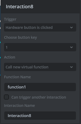

3) Setup in TouchGFX
To use your button in TouchGFX, create an interaction with a trigger "hardware button is clicked" trigger and select the key that you set for the button's GPIO in "MyButtonController".
If you modified your ".touchgfx" physical button section then, you will see your label displayed beside the key in "Choose button key".

You are getting this error because the "MyButtonController.cpp" is only visible by the CubeIDE, you can place both files (".hpp" & ".cpp") in that directory : "<Your_project_folder>\CM7\TouchGFX\target" directly. It should be working in Designer.
