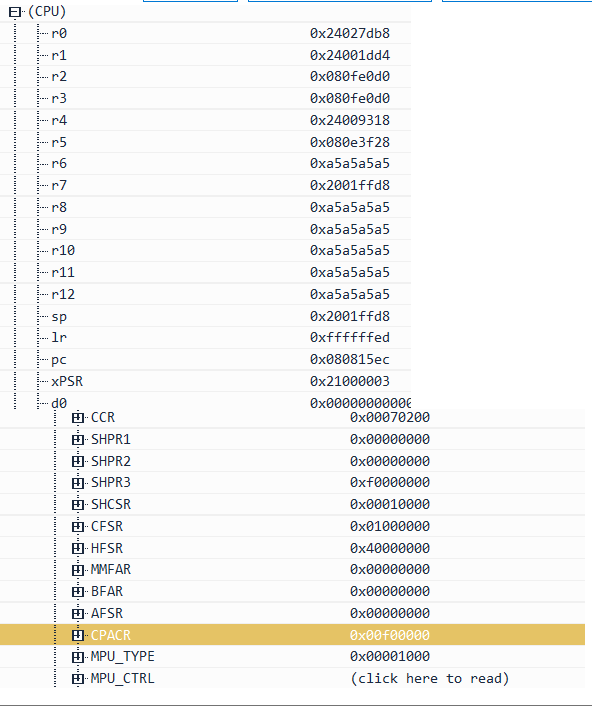

I’m using STM32H753IIT6 part for my development of a LCD display. I am getting a hard fault, when my data size crosses 8752 bytes. I’m using External memory using QSPI and using the FreeRTOS for GUI threads. The flash size is less than <1MB. For data size less than 8752 it works fine and if it crosses this value it hits the hard fault (it breaks inside a routine where I call a function pointer, function pointers are getting same addresses as in
Please help in figuring the issue.

Data from the actual Hard Fault would be most helpful
Instrument Hard Fault so it might output actionable data
https://github.com/cturvey/RandomNinjaChef/blob/main/KeilHardFault.c
Does behaviour change if you don't enable/configure the MPU?

the MPU enable and disable doesn’t make any difference
