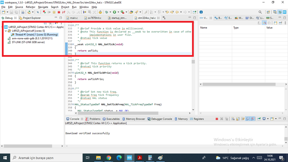

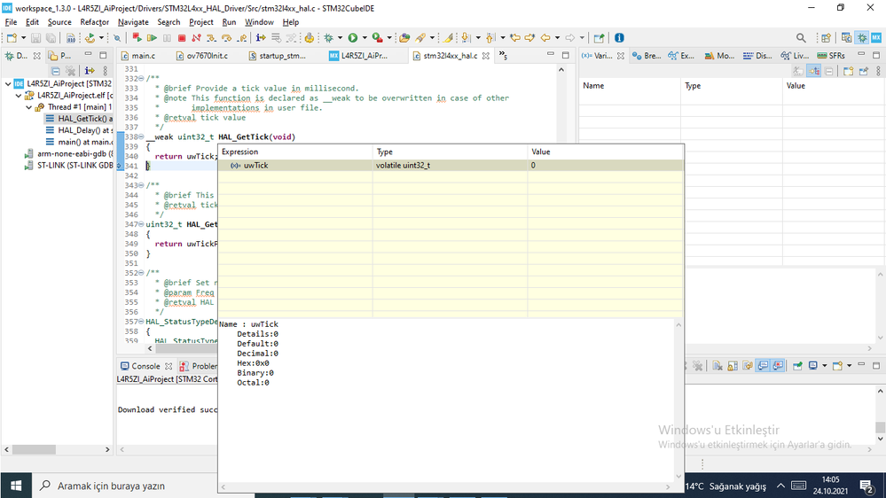

I m using NUCLEO_L4Z5ZI and When i debug or run the code to microcontroller and compiler start to run HAL_DELAY line, HAL_DELAY is staying infinity loop and rest of code can not run or Sometime, MCU is meeting after I pressed to Debug or Run button. But when i plug out to USB cable from NUCLEO_L4Z5ZI and plug in to it again, HAL_DELAY function works well.I try to debug or run the code to it again, I m getting the same problem again until i plug out.(If i make some grammer mistakes, i am apologize to you.

On your images i dont see any code can not compile You maybe mean not run.
Use HAL_Delay need special care. Not use it in ISR and need timebase system (uwtick manager) started before use.
2021-10-24 7:34 AM
I checked againg it is cause of DCMI libraries. When i disable DCMI, HAL_Delay works well but this is not solve my problem either I need to solve this problem or to make frame capture algorithm manually.
