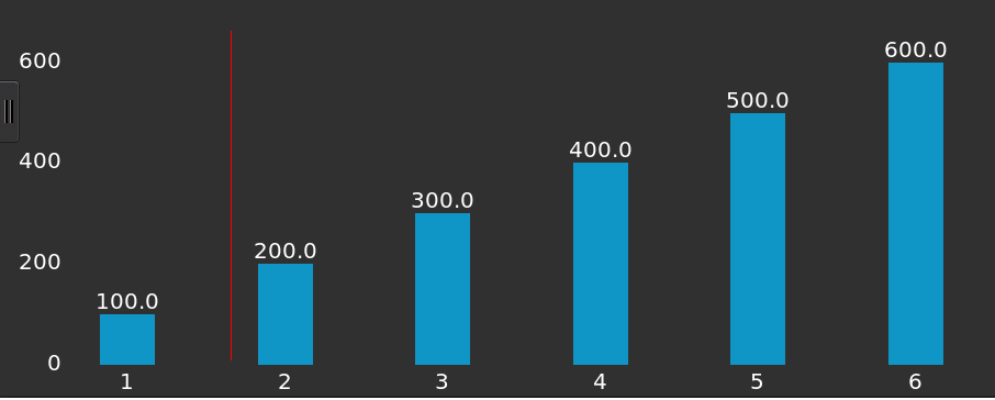

1- The bar width is set to 100 at design time.
2- During execution, we move a red vertical line at the position returned by Graph.indexToScreenX(1). The position returned by Graph.indexToScreenX(1) is 204.
// Original bar width = 100.
testPosX = Graph.indexToScreenX(1); // testPosX = 204
line1.moveTo(Graph.getX() + Graph.indexToScreenX(1), line1.getY());
line1.invalidate();

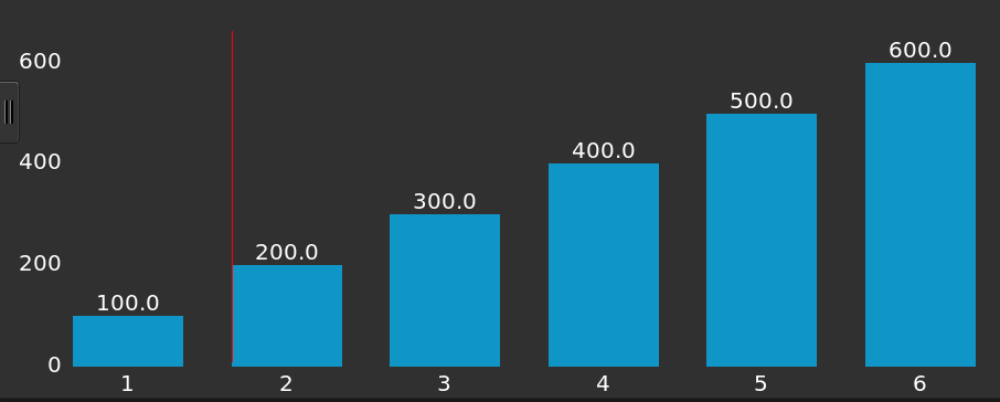

3- Bar width is changed to 50
4- We move the red vertical line at the position returned by Graph.indexToScreenX(1).
But Graph.indexToScreenX(1) still returns 204.
// New bar width = 50;
GraphHistogram1.setBarWidth(50);
line1.invalidate();
We can of course workaround this problem by saving the design time bar width and using it to calculate the real bar coordinate:
int realX = Graph.getX() + Graph.indexToScreenX(1) + (DesignedBarWidth - GraphHistogram1.getBarWidth()) / 2;Secondly, there is a problem with Graph.indexToScreenX(x) returning a coordinate referenced to the graph, and not to the screen as you would expect.
The real screen coordinate is given Graph.getX() + Graph.indexToScreenX(x).
Maybe Graph.indexToScreenX(x) should be re-named Graph.indexToGraphX(x) and the description should be changed.

2023-04-04 2:20 PM
Hi @Yoann KLEIN ,
I was building the small demo when I realized that the issue is not what I thought.
It's not that there is a problem with the X position of the bar not being internally updated.
The problem is that the function Graph.indexToScreenX() does not take into account the Graph Location on the screen AND the Graph Area Margin.
However, for some reason, it does take into account the Graph Area Padding...
It doesn't make much sense to me.
We would expect the Graph.indexToScreenX() to return the position of a histogram bar referenced to the screen.
The indexToScreenX() function should be updated or its name and online description be changed to avoid confusion.
Anyway, as it is now, to get a bar position referenced to the screen we need to add the graph X position and the left margin:
PosBar2 = Graph.indexToScreenX(1) + Graph.getX() + Graph.getGraphAreaMarginLeft();I have attached a working demo, using the code above.
