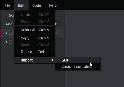

Have you tried my project?
You can load the GUI only by clicking here:
Regards,
