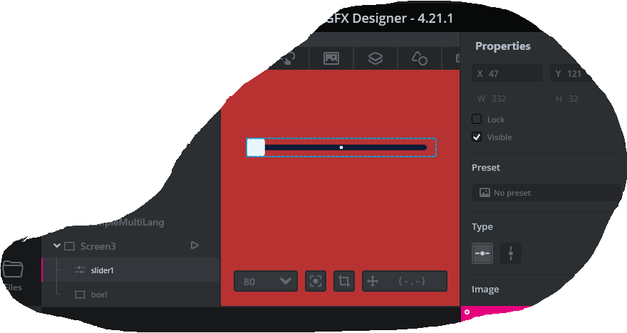

when I place a slider on screen i see this - horizontal by default:

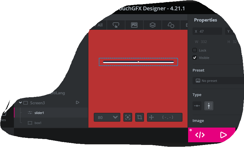

Then I change to vertical and this is shown:
Is this a bug ?
Thanks

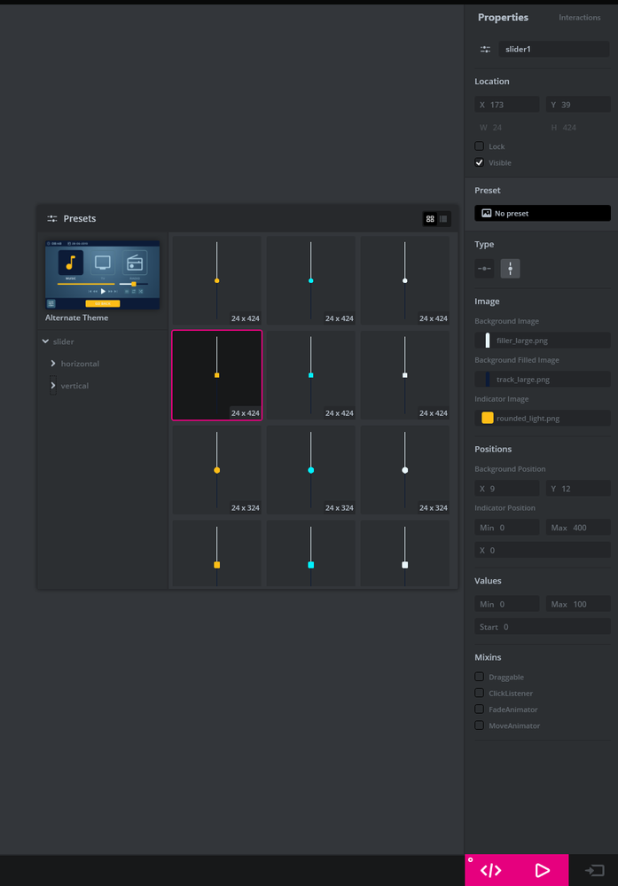

It is not really a bug, but definitely something we should improve in the Designer.
For the moment the image you are using for the slider does not change automatically depending of the orientation you choose for your slider. So, if you want to display a vertical slider, you have to change it manually yourself inside the "Preset" tab, here:
I will discuss the possibility to automatically change to the corresponding preset depending on your slider orientation with my colleagues.
Thanks for the report,
/Yoann

2023-02-14 7:19 AM
"change it manually yourself inside the "Preset" tab"
The "Preset" tab is good enough. Only now I noticed this tab - after more than a month working with Designer.
Thanks.
