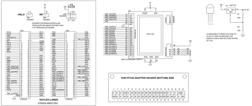

I'm currently working with a NUCLEO-L496ZG eval board connected to an NHD-2.8-240320AF-CSXP-FT (320 x 240 TFT LCD with ST7789 internal controller.)
I've successfully connected up the display via FMC and been able to display colors and images and such to the screen, just using statements like

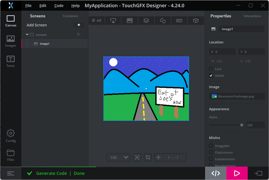

To give you an idea of what I've tried and what my setup is, here's what my TouchGFX setup looks like in the IOC:
After generating the code, I used TouchGFX designer and opened the ApplicationTemplate.touchgfx.part file and then added a simple splash bitmap to the default screen:
(I know, I could quit being an electrical engineer and draw pictures in paint for a living, right?)

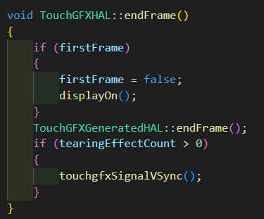

Hello @BWKidd ,
The flashFrameBuffer is used when a certain area of the screen has to be redrawn (basicaly when you invalidate something, change to a different screen, run an animation, etc).
What you should care about is that TouchGFX send a endFrame callback when it is done updating the whole screen. After that you are ready to update a new frame so you should send a vsync signal (do not use a timer for that):
The TouchGFX process is constantly waiting for a vsync signal.

The GPIO pins were configured as follows:

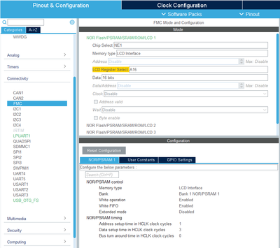

The FMC was enabled and configured:

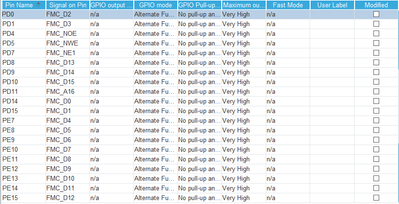

Then the corresponding GPIO Pins configured for use with the FMC:

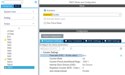

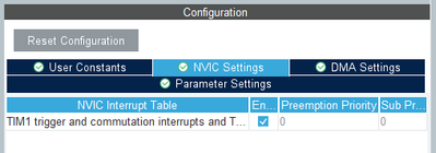

I also activated TIM17 to provide 1 millisecond interrupts for general periodic tasks.
The interrupt was also enabled within the “NVIC Settings” tab.

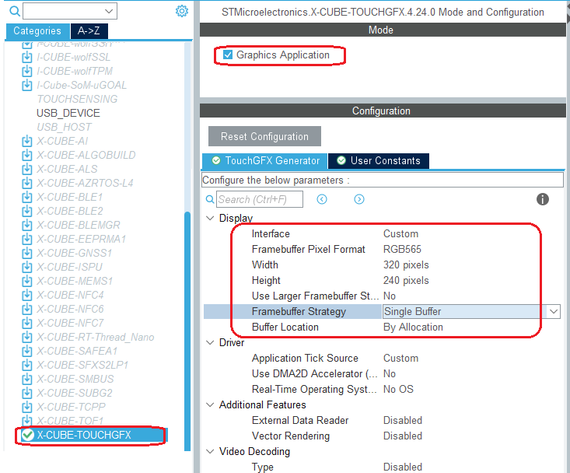

With all that verified and the display operating, I opened the ioc file and clicked on “Middleware and Software Packs” à “TouchGFX”

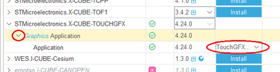

In the Software Packs Component Selector, I had to click the arrow next to the “Graphics Application” to expand it, then select “ToughGFX Generator.

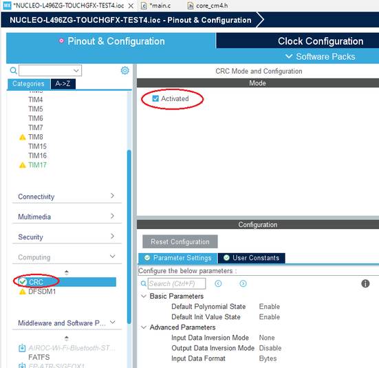

In order to enable TouchGFX, I then had to enable the CRC module:
Back at the X-CUBE-TOUCHGFX item, I clicked the “Graphics Application” and configured TouchGFX:

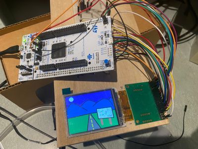

Generating the code in TouchGFX Designer, and then building and running the code from STM32CubeIDE, I now get the image I added to TouchGFX Designer! Victory! Well, small victory anyways, but I’ll take it.
I've attached my main.c, ST7789_DRIVER.h/c files, modified TouchGFXHAL.cpp, and project IOC files.
