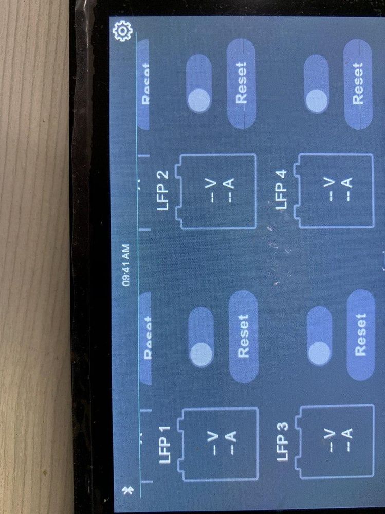

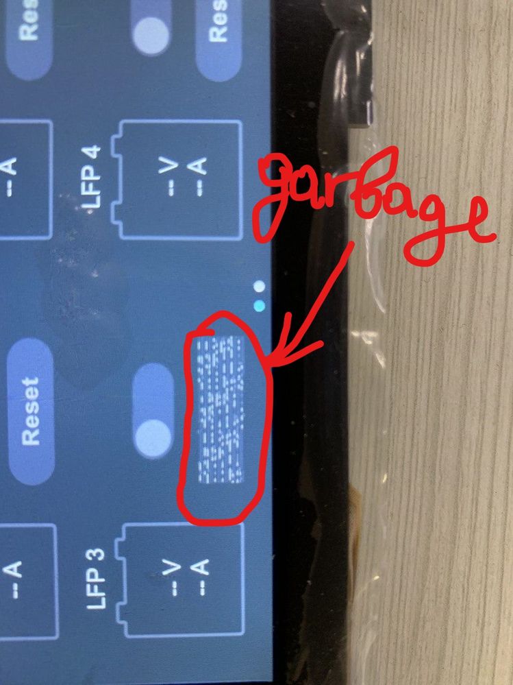

I have some problem with flushing or rendering.
My settings:
Problem - after start UI if we press "Reset" UI button, release image button is corrupted. I am check bitmap and bitmap in framebuffer - they very difference. Result in pic.
After two click this corruption disappears. But similar problem in swap container(upper text label "LFP1") never disappears.
Thank you in advance!

I am add code in function transmitFrameBufferBlock delay before start DMA for FMC:
void transmitFrameBufferBlock(uint8_t* pixels, uint16_t x, uint16_t y, uint16_t w, uint16_t h)
_isTransmittingData = 1;
uint32_t _data_length = w * h;
for(uint32_t i = 0; i < 21300; i++)
asm("nop");
SSD1963_Set_Work_Area(x, y, w, h);
HAL_DMA_Start_IT(&hdma_memtomem_dma2_stream0, (uint32_t)pixels, FMC_DATA_ADR, _data_length);
}Garbage is disappear but flushing very slow. This method is wrong.
