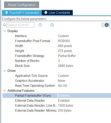

Here is our configuration.

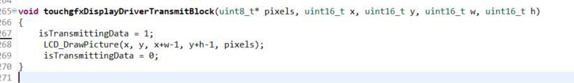

Now the app calls "touchgfxDisplayDriverTransmitBlock" function where we have implemented calling LCD_Drawpicture routine.

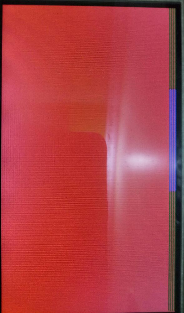

This function gets called and LCD_Drawpicture also works fine, however, we observed that this function always gets variable "h = 3" . Since h is always 3, we are only getting 3 rows on the screen as can be seen in the picture.
(Please ignore RED color, that is what we set in the LCD initialization to check LCD is working, using LCD library, before initializing touchGFX)

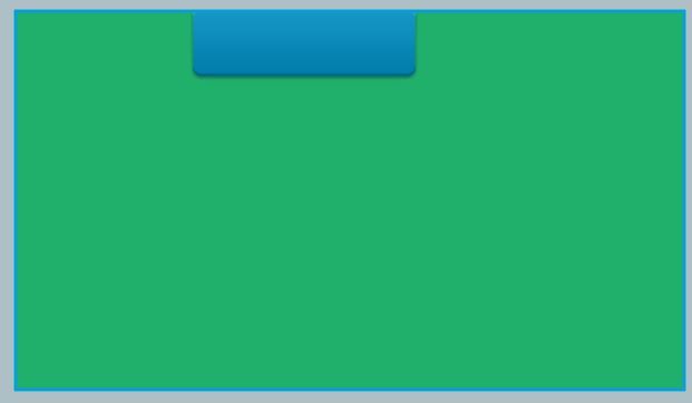

this is what we expect our application to show.

Your custom driver isnt complete and partial buffers read here Lowering Memory Usage with Partial Framebuffer | TouchGFX Documentation
