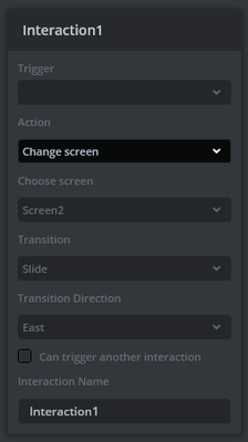

PS. BTW you dont have to write those screen changes manually, it is enough if you add interactions even without any trigger to some of your screen.
Tgfx will then generate those functions to frontend- base class (FrontendApplicationBase.cpp )and they can be called from any screen like:
application().gotoScreen2ScreenSlideTransitionEast();
Or from model-class for example like:
static_cast<FrontendApplication*>(Application::getInstance())->gotoScreen2ScreenSlideTransitionEast();
(add '#include <gui/common/FrontendApplication.hpp>' to model.cpp)
