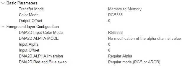

2019-10-09 11:57 PM
Please, see my DMA2D setup bellow
2019-10-10 12:02 AM
Have you any suggestions what should i check?

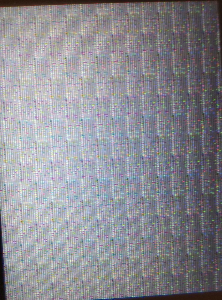

2019-10-10 12:29 AM
When I set LTDC background color i see it. When i generate red box using TouchGFX 4.10 i don't see it (picture bellow).
"Can i see the code for the view where you expect to see something?" - I generating code using TouchGFX 4.10
