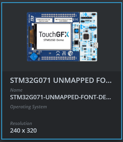

I can suggest you to try a similar configuration as our TouchGFX Designer demo : "STM32G071 Unmapped font demo" for your project.
