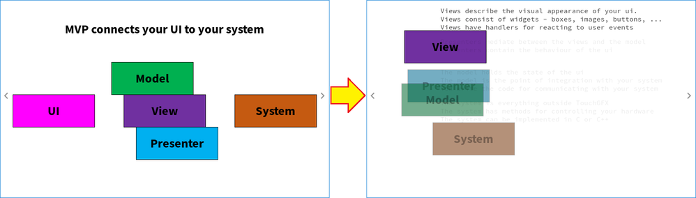

Using TouchGfx 4.14.0, select "Understanding Application Structure" example and run on target (stm32f469i-disco).
It will stack overflow on the 3rd transition:
The cure is to increase stack size from 2048 to 3072 (\TouchGFXProjects\MyApplication_1\Core\Src\main.c, line 69).

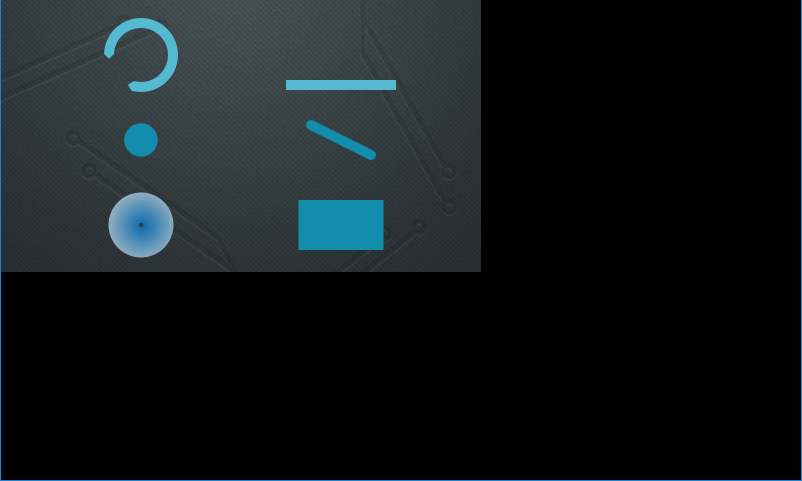

With stm32f469i-disco and TouchGfx 4.14.0:
FlexButtonExample\1.1.0\
TextExample\1.1.0\
TextRotateExample\1.1.0\
ModalWindowExample\1.1.0\
LineAndCircleExample\1.1.0\
PixelDataExample\1.2.0\
ListLayout\1.1.0\
TextureMapperExample\2.0.0\
ClockExample\2.0.0\
TouchGFXDemo2\1.3.0\
Compiling ASM gcc/startup_stm32f469xx.s
Linking TouchGFX/build/bin/target.elf
d:/tools/stm/sw/touchgfx/env/mingw/msys/1.0/gnu-arm-gcc/bin/../lib/gcc/arm-none-eabi/7.3.1/../../../../arm-none-eabi/bin/ld.exe: TouchGFX/build/bin/target.elf section `ExtFlashSection' will not fit in region `QSPI'
d:/tools/stm/sw/touchgfx/env/mingw/msys/1.0/gnu-arm-gcc/bin/../lib/gcc/arm-none-eabi/7.3.1/../../../../arm-none-eabi/bin/ld.exe: region `QSPI' overflowed by 2748568 bytesHope you can double check them and find fixes.

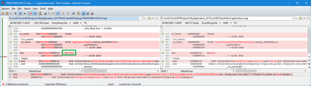

PS: the "black screen" examples work if imported and rebuilt from STM32CubeIDE (Generate Code -> Browse Code -> --\STM32CubeIDE\.project -> Run).
Noticed that resulted STM32CubeIDE\Debug\STM32F469I-DISCO.hex is smaller than the original not-working TouchGFX\build\bin\target.hex and this can be seen in the map too:
