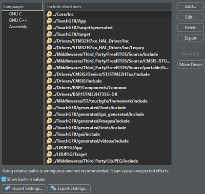

Yes, my projects include path points to the STM32H7xx_HAL_Driver/Inc... Is there any other file that I might be missing ?

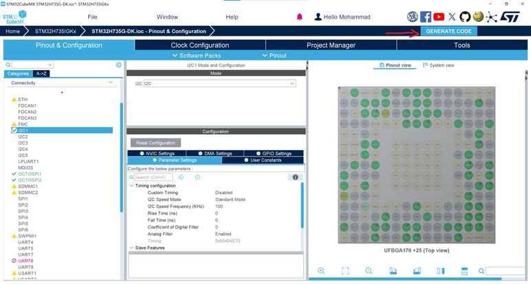

Hello @VH-tech,
I suggest using STM32CubeMX to open the .ioc file, and then you can enable I2C from there and generate code. Then, add your code through STM32CubeIDE.

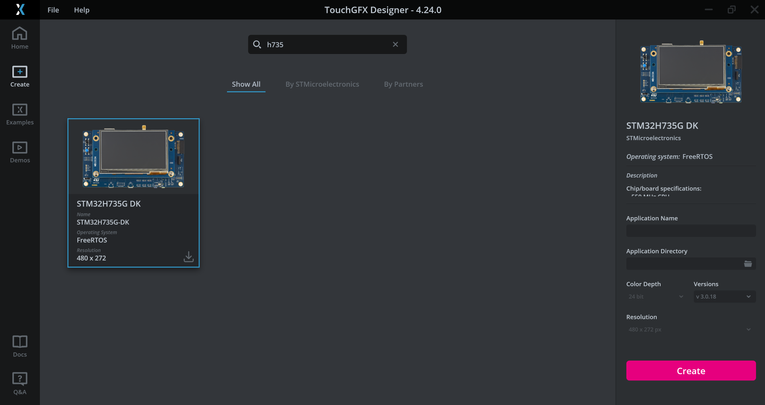

So, you select the STM32H735G-DK from the TouchGFX designer and create a project:
STM32H735G-DK TouchGFX Board Setup
You navigate to one previous level of your TouchGFX project directory, and open the .ioc file using STM32CubeMX:
.ioc file
Then, you enable I2C1 and press Generate Code:
Enabling I2C and generating code
After that, you need to regenerate code from TouchGFX as well, and then you should be able to compile the project from STM32CubeIDE without any errors.
I hope this helps you. Don't hesitate to ask more questions!
