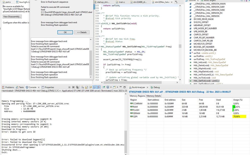

DoneAs a work around I followed this ST post - nothing really changed.
Another example can be seen in the screenshot here:

I add here a log of the ST-Link GDB Server - I think is providing some good infos.
Specifically, seems the STLink speaks a different language than the server. The ST-Link sned a vKill request, which is not understood. But also, why...
[15.763] spawnCubeProgrammer(): 13:21:13:213 Error: failed to download Segment[1]
[15.763] spawnCubeProgrammer(): 13:21:13:213 Error: failed to download the File
[15.763] spawnCubeProgrammer(): ------ Switching context -----
[15.767] WriteFlashDone(): Error in STM32CubeProgrammer
[15.767] write(): <756> Tx: $E05#aa
[15.782] read(): <756> Rx: $vKill;a410#33

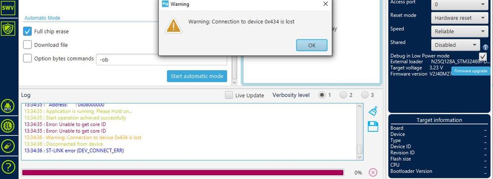

[15.782] handlePacket(): Hidden/Unsupported v-command 'vKill', see RSP for detailsTo finish, I tried with the CubeProgrammer, and the result is the same, it closes the connection
