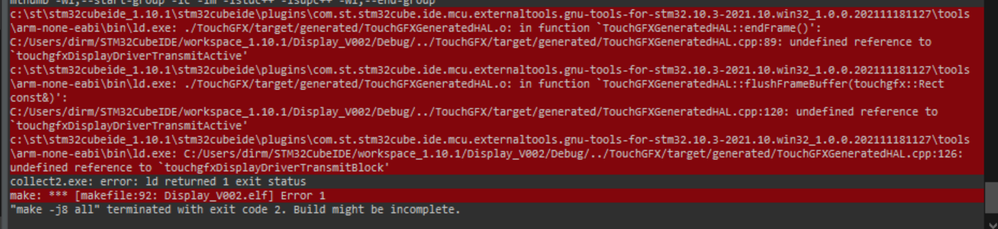

I am trying to set the partial buffer but all I can get are these errors:
How can I fix it?

TGFX bug if you change mode setup (ltdc - custom, single - partial ...) delete target folder before generate code.

Thank you for your answer. Unfortunately I keep having the same error even after deleting the whole TouchGFX folder :(

I dont test latest but my old partial project is generated with this info in target cpp file
#error "A user must call touchgfx::startNewTransfer(); once touchgfxDisplayDriverTransmitBlock() has succesfully sent a block."
#error "A user must implement C-methods touchgfxDisplayDriverTransmitActive() and touchgfxDisplayDriverTransmitBlock() used by the Partial Framebuffer Strategy."You need do what is writed and after implement comment this lines out.

there you can see how this has to be implemented
