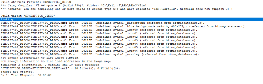

I have same problem with MDK-ARM (Keilc)
i have follow your recommend, but it not solve
My project have a image and some button with purpose to test TouchGFX 4.13 running with CubeMX 5.5.
How can i solve this problem.
