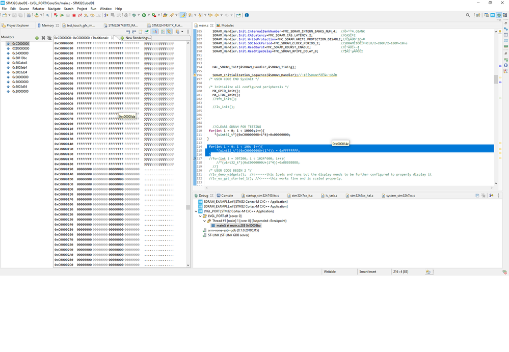

Memory after rendering the first 50 pixels

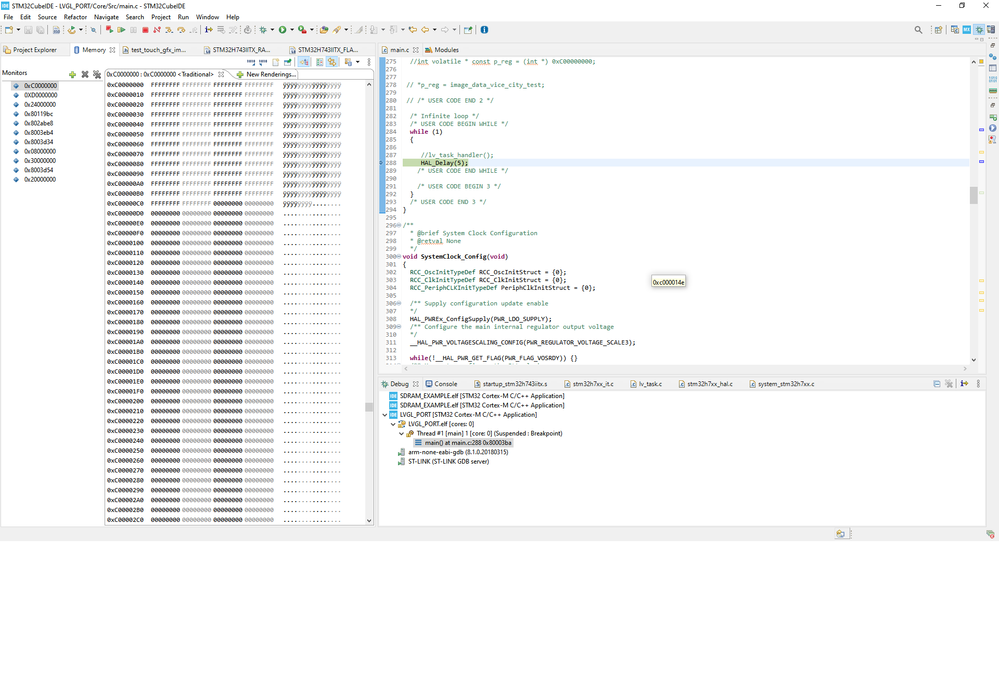

Memory after rendering 100 pixels

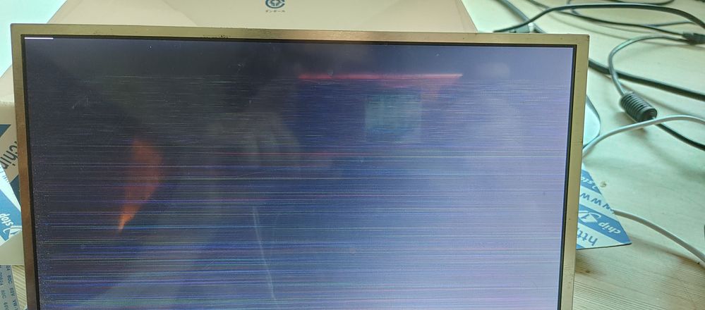

Photo of screen rendering 50 Pixels

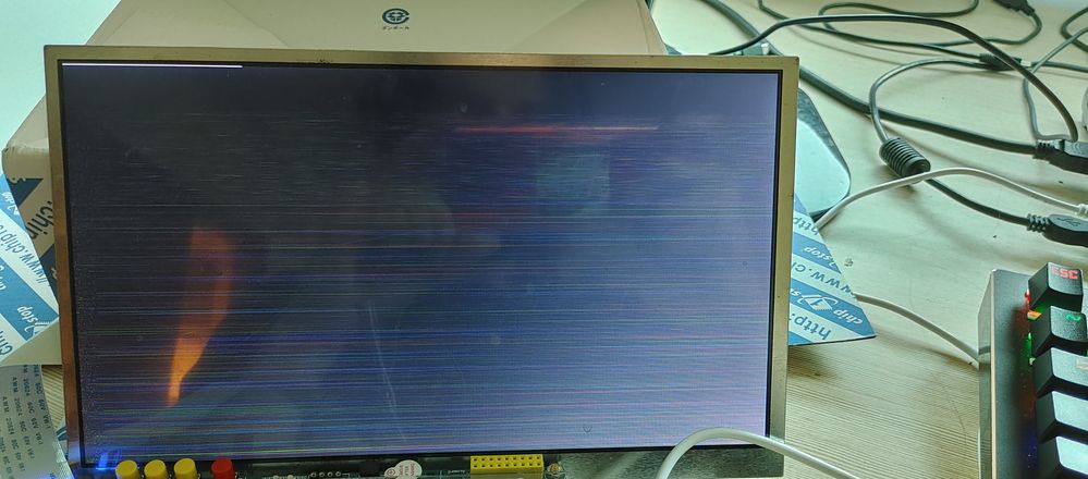

Photo of screen rendering 100 Pixels
It might be hard to see in the second picture but the scale is obviously wrong and if I had a gif you'd see the line is jumping right then back again then right constantly in a weird dithering pattern.
