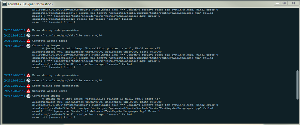

I selected "STM32F769I-DSCO" and configured "Tiled imgae" and executed "Generate code", "Error during code generation" occurs.
However, if you run the same procedure and method on another PC, the code will be generated normally.
It is a symptom to remove the program and reinstall it.
Please help me if you know why.

What happens if you try to compile through the TouchGFX Environment command line? "make -f simulator/gcc/Makefile". I'm expecting the same thing.
It's been a while since i've heard about this issue. Which version of windows are you running?

How are your machine resources looking? RAM, Virtual memory in windows, etc?

Sometimes it's because another version of msys.dll is in your path (than what is in our environment).
