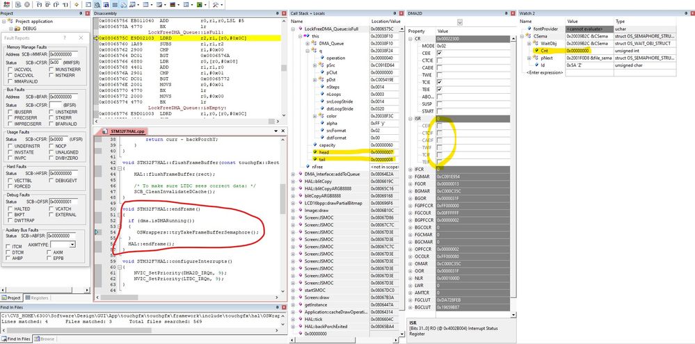

The suggested fix in the "TouchGFX Known Issues" didn't work on V4.9.3 then I upgraded to V4.12.3 still the same problem. TouchGFX core stays in addToQueue() function waiting for Queue to be available.
Attached is the screenshot of the Keil-IDE screen while in this state which contains:
2019-10-31 5:33 AM
