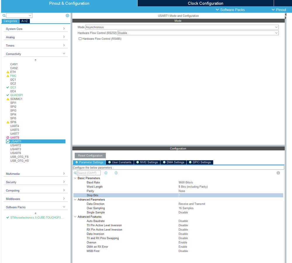

Hello @PM.5 ,
I did a simple example for you on the STM32F746G-DISCO board, I will join it to this post.
To explain quickly what I did for making it work :

}Now, if you wanna try it out, you can use a tool like Putty for simulating the UART value transmission part :
This project could be improved, for example by using interrupts instead, but I think that might be a good start for you.
Hope that it helped,
/Yoann
