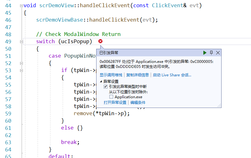

I dynamic create widget by 'new' and delete by 'delete', but the project crash when delete it.

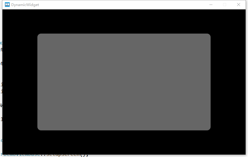

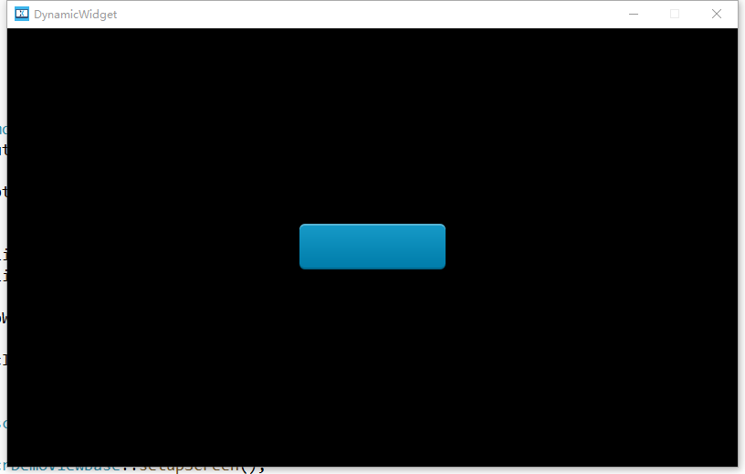

Hi @Yoann KLEIN
1, It create a screen with a button at system start;
2, Click the button to new a "Modal Window" with a gray image;
3, Click area without the the gray image to return then delete;
2022-09-25 5:20 PM
Hi @Yoann KLEIN
class Screen
Drawable* focus; ///< The drawable currently in focus (set when DOWN_PRESSED is received).
This was the root of the crash problem I think.
"focus" need clear to NULL when the "Modal Window" was been deleted.
Do you agree?
