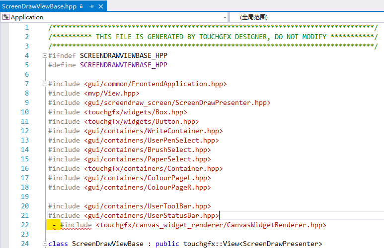

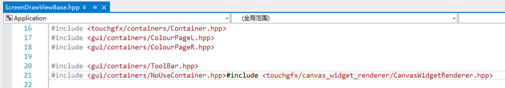

#include <gui/containers/ToolBar.hpp>
#include <gui/containers/NoUseContainer.hpp>#include <touchgfx/canvas_widget_renderer/CanvasWidgetRenderer.hpp>

Thank you for your reply.

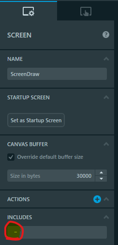

I don't know why this happened.Maybe adding too many header files will cause this bug.There is a blank line on line 19.If I Remove ToolBar.hpp&NoUseContainer.hpp out of the screen,CanvasWidgetRenderer.hpp can be added correctly.Now my solution is to add a space to the designer's include.I will show you the screenshot.
“ - �? is added to 'INCLUDE'.

That's clever. Thanks for the report =) I've verified this with others and its been reported as a bug.
I'll just mark your "solution" as an answer to your own question in case people come across this.
