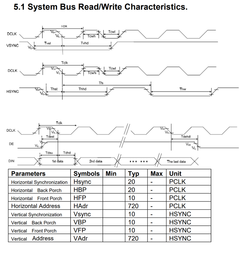

I used this display, the porch settings are

ok and valid pclk? try show ltdc init code

They are not written in the datasheet, however it is working with 25MHz
2021-01-27 4:30 AM
In datasheet is defined as Tclk on your image then seach time def and calculate f.
And pls show ltdc init function from your code

I don't understand what you mean with "In datasheet is defined as Tclk on your image then seach time def and calculate f.".

From you datasheet image DE signal seems be active HIGH, but you set in ltdc AL. try change AH and too clock polarity...
And Tclk is time period for pixel clock. Then maybe in datasheet is definet as MAX Tclk for example 100ns , that is min freq 10MHz
and min Tclk for example 20ns .... 50MHz
