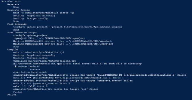

The function MathOp was created for the arithmetic calculation which was called in the model.cpp file. Below is the error from the simulator on Touch GFX Designer:
2024-03-01 3:26 AM
Hello again,
Unfortunately, I can see there is an issue with adding additional sources to the simulator Makefile. I suggest placing your files (Mytest.h and Mytest.c) inside the gui/include/gui/common and gui/src/common respectively for testing (although, it ruins the purpose of calling MathOP from the Model.cpp, but still it is a test).
But, when you want to flash your board with the GUI, remember to add the correct include and the function call under the #ifndef SIMULATOR guard.
Sorry for the inconvenience, we will try to fix that issue as soon as possible.
Good luck
2024-03-11 3:30 AM - edited 2024-03-11 3:49 AM
Hi Mohammad, yes I've added my files into the gui and tried adding the correct includes and the function to call under the #ifndef SIMULATOR guard but that didn't work either. I've started the project again and provided the files and what we have done again, please have a look and let me know if there is anyway around the issue, that would help. Thank you.

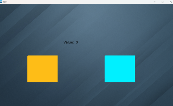

Currently, the code builds fine with no error at simulator and does what its intended for. When the yellow button is pressed, we get the sum of the values (The values which were passed from Screen1View ).
Similarly, when the blue button is pressed, we get the difference of the values.
