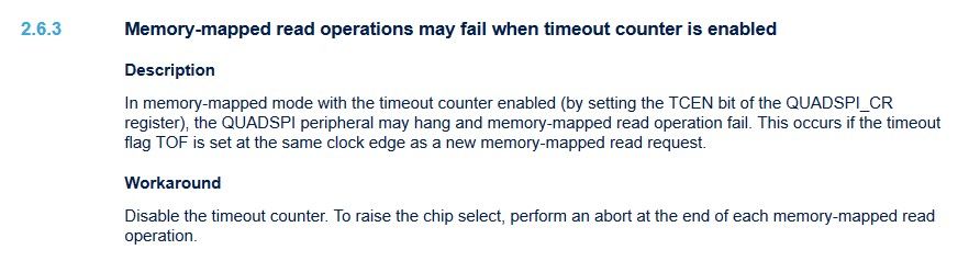

Update: I disabled the QSPI timeout counter as mentioned in the device errata and the problem appears to have gone away.
