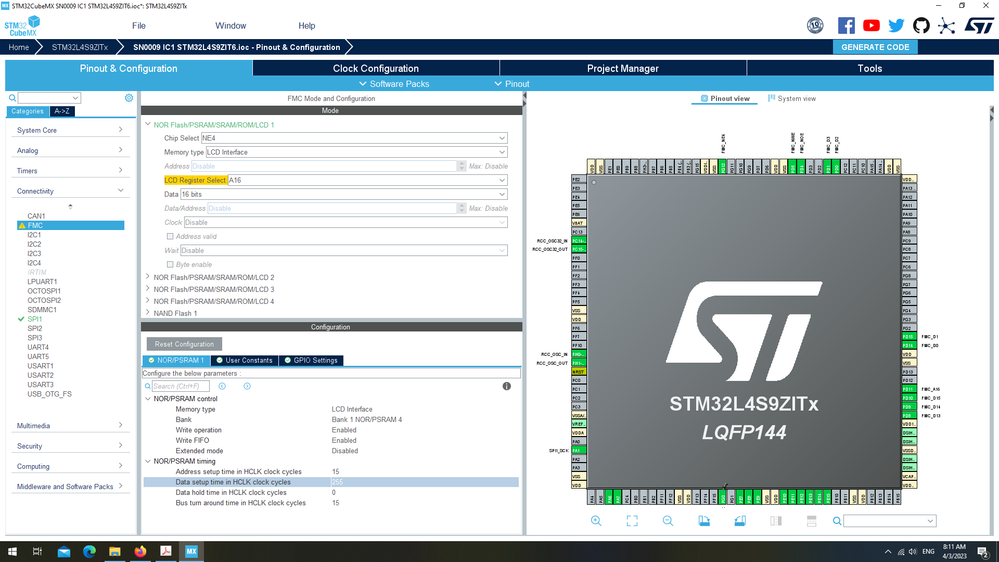

I think the problem might be with the address to send command and data. I am using STM32L4Q5RGT6

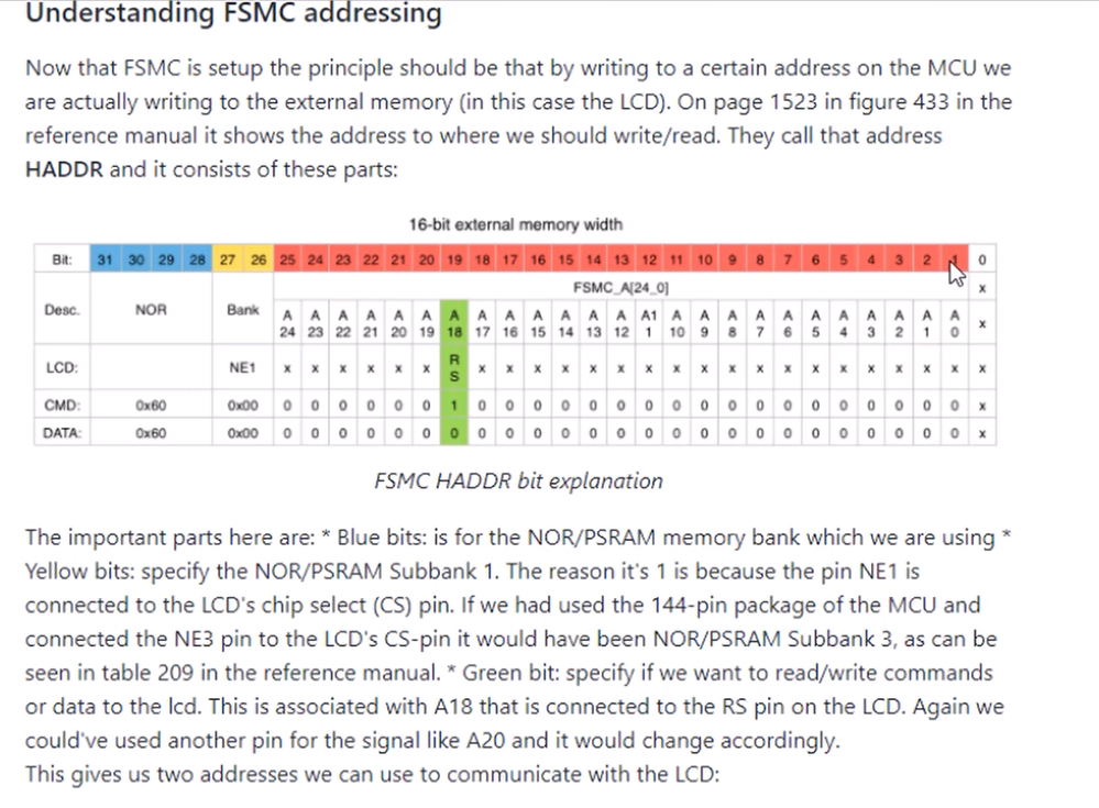

I think that it should be for data
*(__IO uint32_t *)(0x6C020000) = data;
0110 1100 0000 0010 000 0000 0000 00000
I found this but I wonder if each STM32 has the same address mapping for FMC

0x40000 offset looks correct for A16 address bit in 16-bit mode

I am checking all data sheets and I think that it might be
*(__IO uint32_t *)(0x60008000) = data;
for data if I use A16 for LCD register

You could always write to an address spanning the boundary and view on a scope or logic analyzer
Perhaps 0x20000, pretty sure not 0x8000
2023-04-03 10:37 AM
Yes, but for FSMC_NE4 the base is not 0x6000'0000 but 0x6C00'0000.

Where did you find that bit explanation table?
