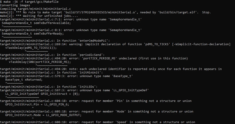

I created an gui with designer and now want to add my UART implementation (C) that uses LL drivers. Bunch of compilation errors are displayed when trying to compile it.

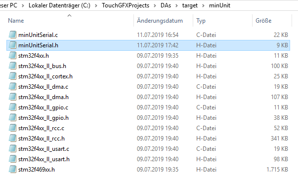

I added the .h/.c files and the used ll .c/.h files to minUnit folder under target/minUnit (refer to image below)
I editted the gcc/Makefile include paths:
#keep framework include and source out of this mess! :)
include_paths := $(library_includes) $(foreach comp, $(all_components), $(comp)/include) $(framework_includes) $(source_bsp_paths) target/minUnit
source_paths = $(foreach comp, $(all_components), $(comp)/src) target/minUnitminUnitSerial.h includes the ll_drivers:

#include <string.h>in the target/main.cpp i included the minUnitSerial.h and called a function in main() loop. I do not know what to do to fix the problem.
Does anyone has a clue? Thank you in advance!

So I moved the ll driver source files to

$(bsp_path)/source/platform/hal/mcu/stm32f4cube/CMSIS/system_stm32f4xx.cnow if i remove the minUnit.c/.h files, it compiles the ll driver files. The only problem is adding my own .c/.h files to the application. My limited knowledge of makefiles gets in the way.
Maybe someone can help
