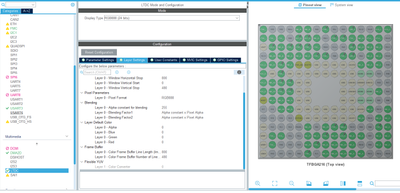

I am currently working on some project with the "LIZARD Board" from Actron and a 800*480 LCD-screen.
I followed the Instruction in https://support.touchgfx.com/docs/development/board-bring-up/how-to/03-display-internal
and also other "tutorials" but wasnt able to get it to work.
Now i finally noticed that the "Color Frame Buffer Start Address" in LTDC is missing...
I have no idea why that is the case and if this a bug in CubeIDE v.1.17.0 or something on my side.
Does anyone know what to do?

How do you figure that the color frame buffer in LTDC is missing?
Can you look at the STM32U5G9J-DK2 TBS and compare it to your project? The STM32U5G9J-DK2 is also using LTDC, you can just change from double to single framebuffer in STM32CubeMX.

Hello @GaetanGodart
I updated STM32CubeIDE to the latest version 1.18.1 and this bug resolved itself.
The missing entry instantly appeared after i migrated my project to this version and opened the .ioc to check.
I still dont know what caused this but it seems fixed now.
Thank you for your suggestion!
