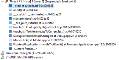

Thanks for the quick reply. I don't know how to get the stack call since the program didn't crash but actually navigated to an infinite loop. I am not familiar with CubeIDE.
I tried to call the goto____NoTransition function from a presenter and it went to the infinite loop again.
The thing I forgot to say is, actually the screen transition happens. I can see the new screen on my display then nothing responds. When I pause the program using IDE, I can see that it is in syscall.c -> _exit function.
I placed a breakpoint to my line:
static_cast<FrontendApplication*>(Application::getInstance())->gotoScreen2ScreenNoTransition();Then I moved step by step and when I got to the _exit function, the list on the left side (I hope this is the stack trace) was like this:

Now I realize that something is wrong about the resizeToCurrentText. I'll investigate.

2024-12-02 11:18 PM - edited 2024-12-02 11:24 PM
Somehow the problem was me calling resizeToCurrentText() function of TextArea.
Let me show you my whole Model.cpp
The line 59 is the line 52 here. Where I call something from debugWidgetPointer.
