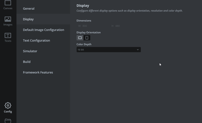

The issue seems to be that you would like to force to regenerate the assets, in that case, maybe you can try to change the display configuration like the color depth:

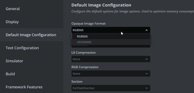

or the image format:
