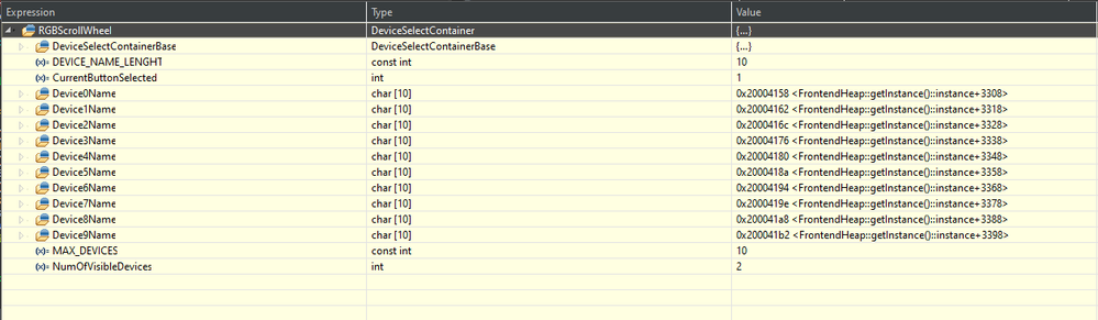

May be I met the same problem. Due to the custom container won't accept to use the presenter and model, so we can't save directly data from these container to the model. But in Screen View we can. Each Container is define in view and in this view we can access to any children of this object. You can see my custom container below:
So in Custom Container, we can save the variable which need to save to model as public variable in CustomContainerView.hpp like:
public:
int YourVariable = 10;and in .cpp file, you can modify this variable in callback function or something like that.
In ScreenView, simply you only need to call this variable and save them to model manually:
YourCustomContainer.YourVariable;Hieu
