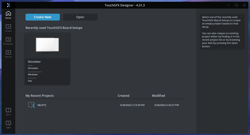

I'm developer on linux.
I using TouchGFX 4.21.3 on bottles(flatpak) application.
=== environment ===
OS: Manjaro Linux
Kernel: linux-6.1.19
Window manager: KDE plasma 5.26.5
flatpak Ver. : 1.15.2
Bottles Ver. : 51.5
HW:
CPU: AMD Ryzen 5 3600
GPU: nVIDIA GeForce GT710
RAM: 16GiB
My settings are as follows:
1. Create a new bottles
2.Option -> SettingsIn addition to the settings used in the above picture, other defaults are fine.
3.Option -> DependenciesAdditional installation "vcredist2012" & "allfonts"
4.Install TouchGFX 4.21.3 & startup application.

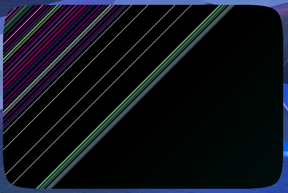

splash screen will be problematic
But it is normal to enter the main screen.
Sorry my poor english.

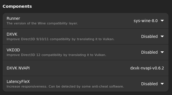

I couldn't get it to work using wine but soda launched fine (even the splash is shown correctly). Unfortunately, network connection isn't working, so it becomes pretty unusable.

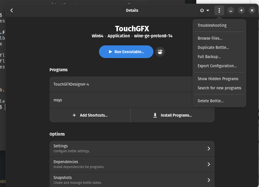

2023-08-31 10:05 PM
I got the latest version fully working in Bottles, including networking.
Almost everything should be working now. Enjoy!
Run target (flashing) isn't working and I don't know if is possible to pass the st-link usb connection to Wine/Bottles, but I'm ok with this.
2023-09-06 12:34 PM - edited 2023-09-06 3:49 PM
So great! I have TouchGFX 4.22 in LINUX!
Couple of tips:

I can't say I'm having much luck here. I've followed the steps above but without success.
Linux Mint 21.3
AMD Ryzen 9
Bottles 51.13
TocuhGFX 4.10.0
Tried the different runners above.
I'm on an Asus machine & can't see the DXVK NVAPI option
