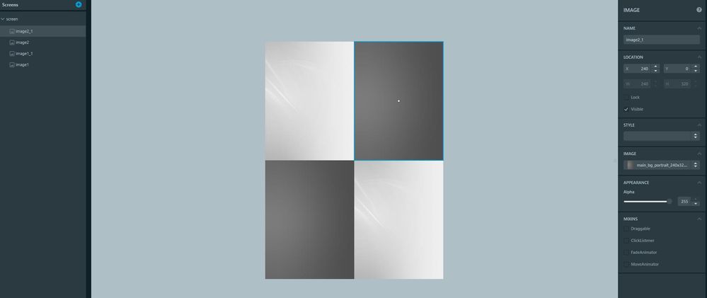

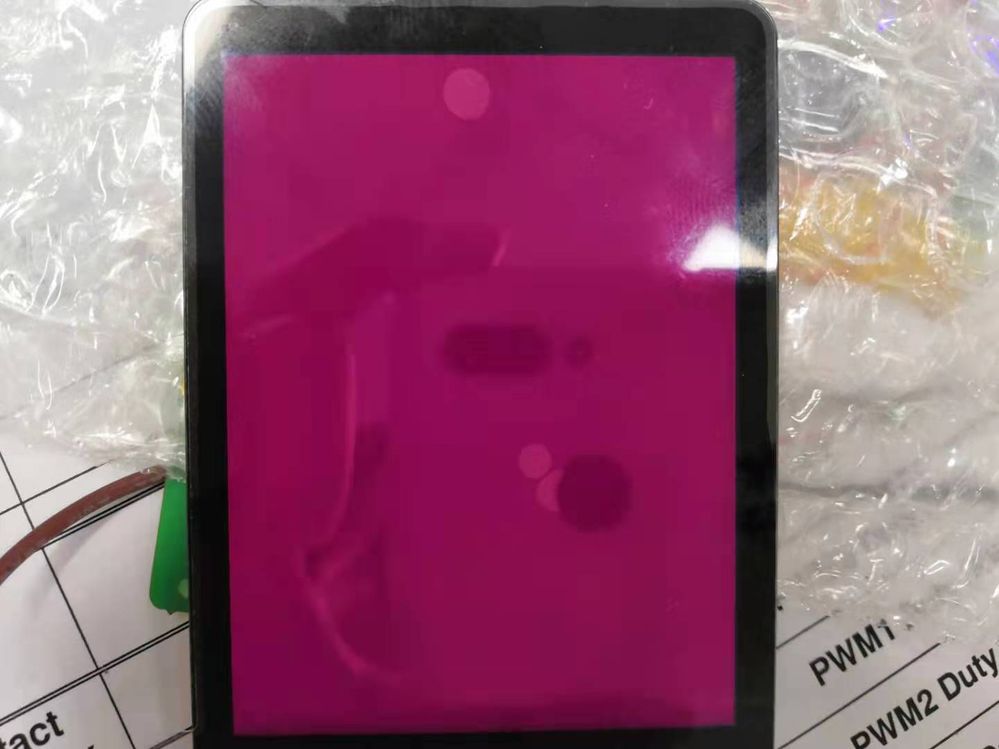

Touchgfx project with images:
display like this:

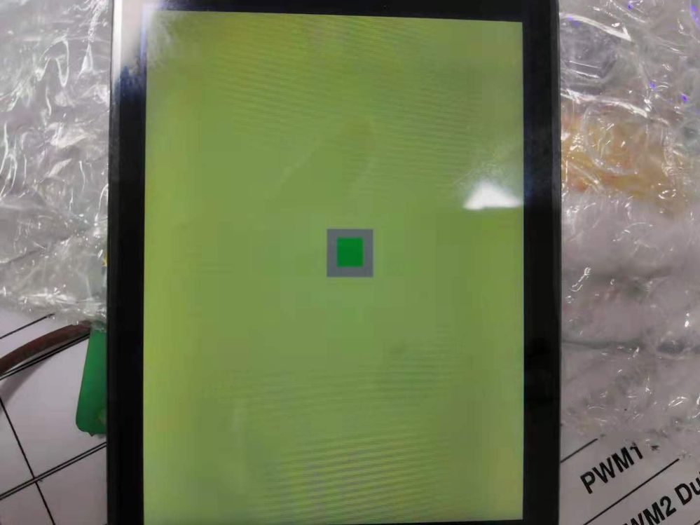

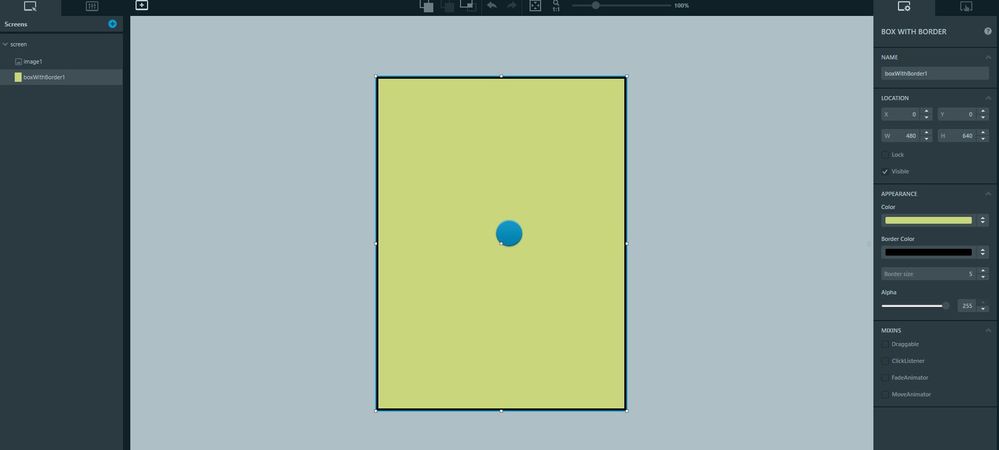

touchgfx project with image&pixel:
display like this:
