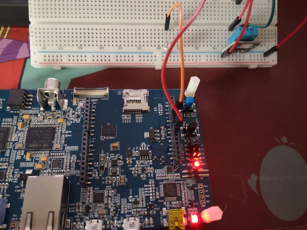

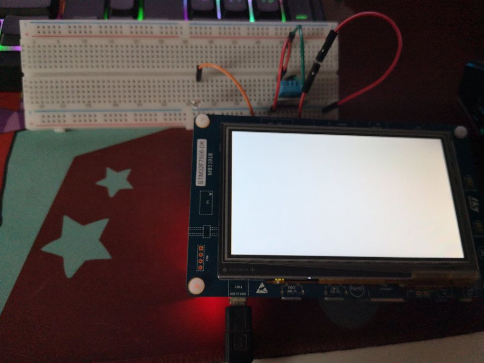

Pretend in everything? I tried run it like it would be F746G-DISCO on several ways, this from video too, but in this case it not even run. It's trying to erase memory, but it can't so my program is not even on the device and I have errors connected with STM32F746G_DISCO.elf. I see white screen like here. LED which I was testing not working too0693W00000AOO4AQAX.jpgif I reset my device I see old program, but still pins somehow don't want to work doesn't matter it's F7508-DK or pretending F746G
Bellow I send how I connect pins for exclude story with wrong connected pins. I'm sure program which I wrote is okay, coz on other device I wrote it simillar (other pins) and it works fine. All I'm trying to do for now is only blinking led what should be very easy
