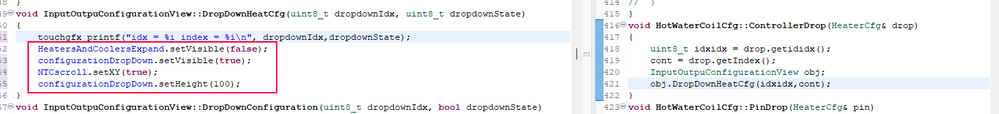

Here goes when callback gets call. And I create an object of other class to call function:
And goes to this function:
The problem with this method is that does not perform commands like "setXY" and etc. but only touchgfx_printf works. What I do wrong?

2023-03-02 11:03 PM
I don't understand why does not perform this function (marked in red)
Only prints text and when go through functions and do nothing. I just call function from another class and give them indexes

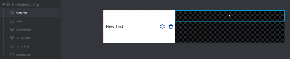

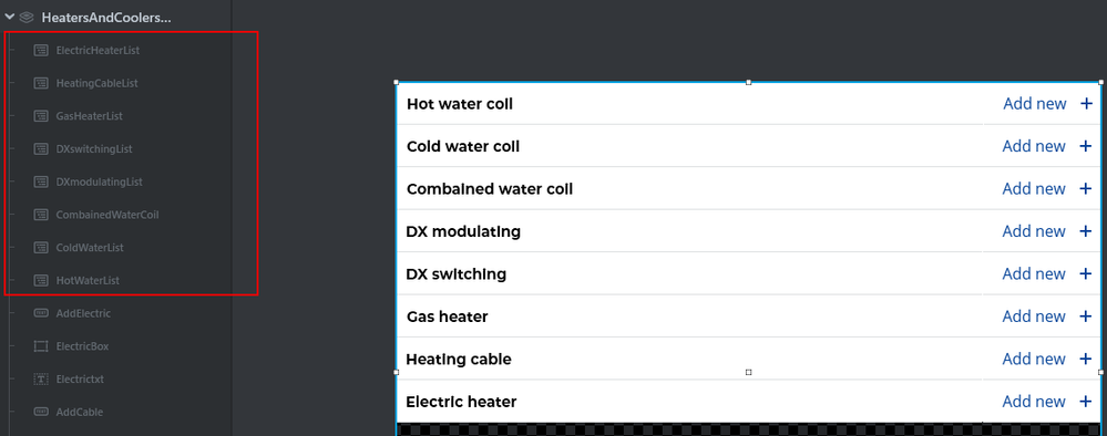

For better understanding what I want to do I try to explain. First of all in my view window is container and in that container I create a list using another container. On the left is my lists.
This is what I put in list and in this container I put another list:

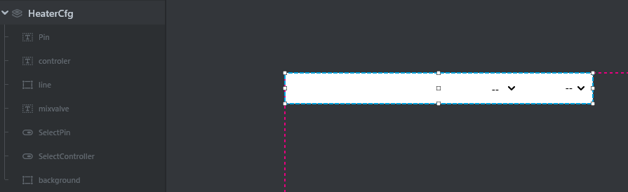

So here is "SelectController" button and for that I create callback and by click I get index of that button:
So I pass that index by pointer in HeatersAndCoolersConfiguration class

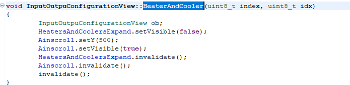

And this is my function in my view window:
Problem is that simulator crashes when I click SelectController button.
