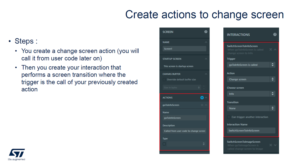

Hello Dfarr.1,
You need to use the action and trigger concept.
You create an action called changeScreen for instance and then you create an interaction that is triggered when this action is called. This interaction will initiate the screen transition. Then you just need to call changeScreen() in your View according to the state you received from the model.
/Alexandre

Ok I created an action to trigger a change screen interaction in the designer. I'm calling that action in the view based on model state. This still doesn't cause a screen transition. No surprise really, since the interaction simply wraps application().gotoScreenNoTransition() which is what I was calling in my last attempt.
I can make screen transitions from just about anywhere without issue. Except presenter.activate() and view.SetupScreen(). Is some special consideration required when executing screen transition from these locations?
