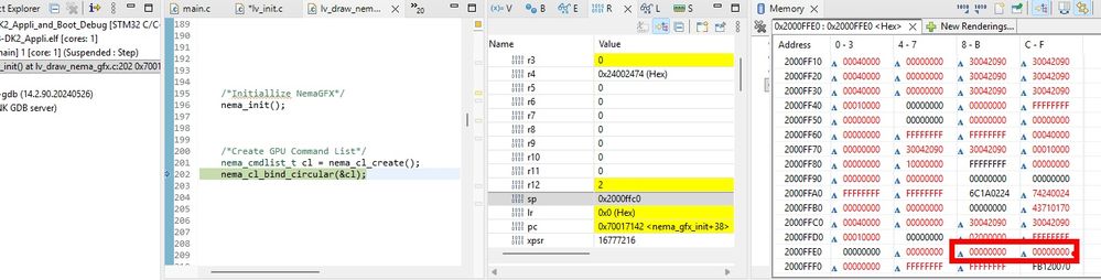

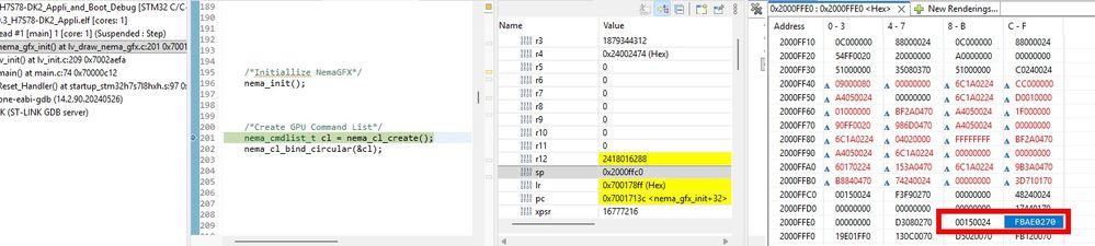

the stack is overwritten with values, so the return address on stack (0x7002AEFB) is no longer available (0x00000000) and the cpu goes in hard fault.
I suspect it's a bug in the NEMA library.
The correct version for the H7 series was used.
The error occurs with both versions: libnemagfx-float-abi-hard.a and libnemagfx.a.

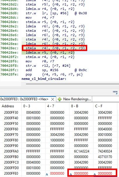

I looked inside the function in the disassembler, and at the end of the function, registers r0-r3 are written to the stack, but much too far! (See images)
Stack bevore calling nema_cl_create. Return-adress: okStack bevore calling nema_cl_create. Return-adress: ok
Stack after calling nema_cl_create. Return-adress: 0x00000000Stack after calling nema_cl_create. Return-adress: 0x00000000
Dissass. inside der nema_cl_create: overwriting behind actual stack endDissass. inside der nema_cl_create: overwriting behind actual stack end
