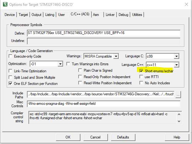

I created a new project from scratch (with the stm32f746-disco board)
and TouchGFX works fine with ARMCLANG, as long as you don't use the Middleware from Keil (at least the File System & USB libary).
Then linker error occurs.
I figured out that:
TouchGFX only links when "Short enums/wchar" is disabled
Middleware only links when "Short enums/wchar" is enabled
Keil mentioned : "The wchar_t type must be the same in all source and libraries to successfully link."
Can you build the library with "Short enums/wchar" enabled? This should fix the problem.

2020-02-03 2:30 AM
Hi @Martin KJELDSEN
Thanks.
Now I get a lot less linker errors: (I enabled the "Short enums/wchar" option)

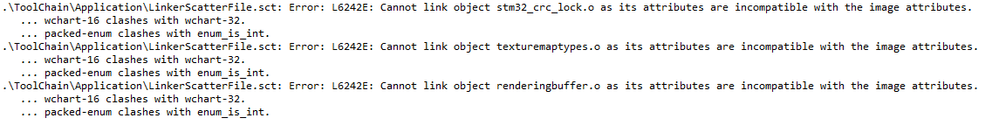

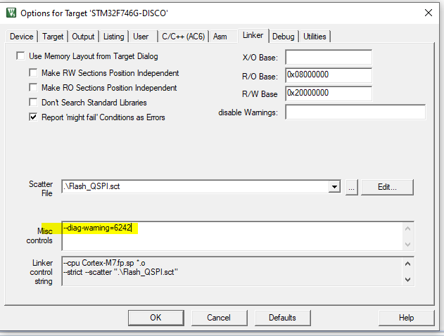

2020-02-03 2:50 PM
I tried it myself and got the same linker errors.
You can demote the linker error message to a warning by adding "--diag-warning=6242" in the Linker-Tab.
But I don't feel particularly comfortable doing this...

2020-02-04 2:40 AM
As you can see in an above screenshot, we had a lot more errors (we came from about 44 errors down to 3). They disappeared with the new library.
Why they didn't fix the errors on stm32_crc_lock, texturemaptypes, renderingbuffer is a good question.
Do these files have a seperate configuration? (in Keil I think you can change the setting also per file basis...)
2020-02-04 2:45 AM
There are no special settings for those files and they inherit the global settings of "short wchar". I'll have to look into it.
