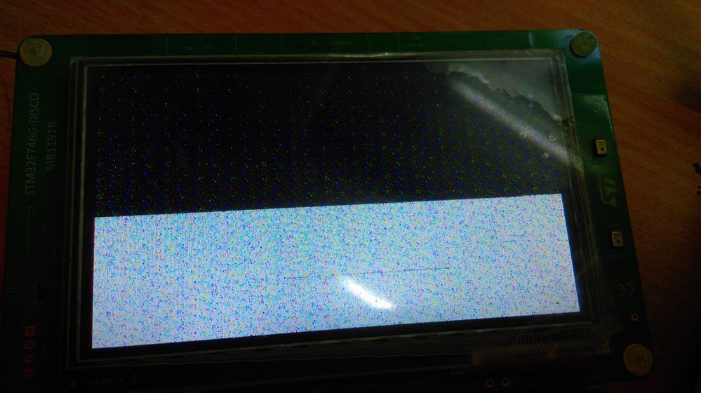

I had started my project in TouchGFX 4.9.3 but I want to continue it in TouchGFX 4.10.0
So I upgraded the existing project.
And without making changes I flashed the same code.
But the board display does not work. It shows as per attached image.
Why is it happening?

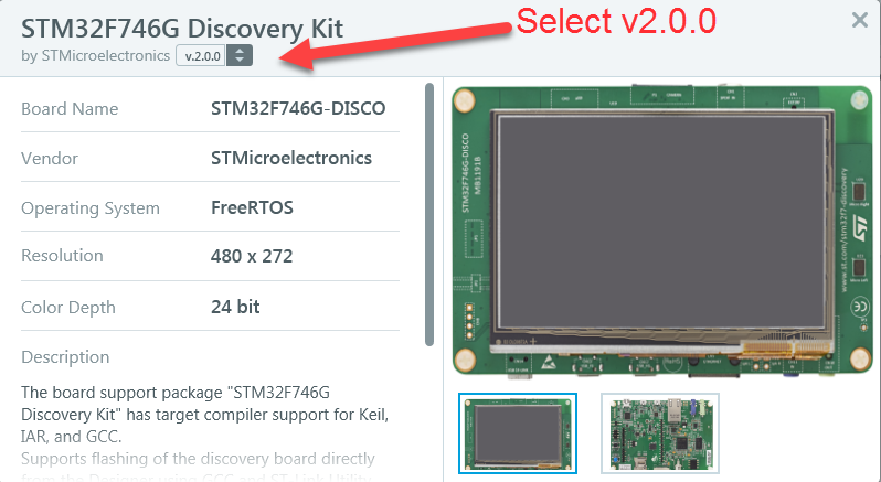

One trick you can try is:
1) Close all programs.
2) Launch Touch GFX 4.10.0
3) Change the target to be your kit BUT be sure to select the v2.0.0 template from this start phase.
4) Proceed to create a short GUI background with button, etc. for testing.
5) Generate the code. Simulate the code.
If this works, open the code folder (bottom right side of the TouchGFX tool.
Review to locate the Keil folder and launch the project. Allow for Keil to build your generated code.
Does that work? If not, then the Keil integration is still broken. From some limited experience, if the kit is upgraded to the v2.0.0 template, then the tool has been fixed.
