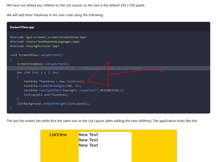

Interesting find in this post:
https://community.st.com/t5/stm32-mcus-touchgfx-and-gui/memory-leak-in-an-example/td-p/670537
example by Gfx uses 'new' for widgets
https://support.touchgfx.com/docs/development/ui-development/ui-components/containers/list-layout

Create a buffer where you will store your widgets' addresses that will act as a heap.
Add your widget as previously.
This way you won't run out of memory nor use all the available memory.
Also, you don't have to store your widgets in a vector, instead you can just move the heap index to the beginning of the heap.
uint32_t myheap[10000];
uint8_t* heapTop = 0;
uint8_t* heapEnd = 0;
void Screen2View::setupScreen()
heapTop = (uint8_t*)myheap;
heapEnd = heapTop + sizeof(myheap);
Screen2ViewBase::setupScreen();
void Screen2View::handleTickEvent()
void* memory = heapTop;
heapTop += sizeof(touchgfx::Box);
if (heapTop > heapEnd) return;
touchgfx::Box* box2 = new (memory) touchgfx::Box;
add(*box2);
box2->invalidate();
Note that the code snippets provided are just here as examples, we tried them earlier but I am not sure they are exactly what we tried.
I hope this clears things up! :smiling_face_with_smiling_eyes:
Regards,
2024-06-16 2:36 PM - edited 2024-06-18 2:32 AM
Very thorough answer, thank you.
>"You should be concerned about running out of memory"
What I meant was; "Apart from the memory limitation, are there some 'behind the scene' mechanisms running by Gfx a user need to be aware of ?"
>"Yes, Osman gave a simpler answer, basically "You shouldn't do it" for more beginner level. I answered "It is possible but should be avoided" which is also a simplification because precautions should be taken (c.f. below)."
Okay, things are starting to make sense now.
>"Are you creating widgets at runtime in your STemWin applications?"
I am not familiar with STemWin. Want to focus on Gfx. Might add to this answer later when I know more.
>"How to properly add widgets at runtime"
Splendid, thank you for these examples.
What I do is:
// ScreenView.hpp
#include <memory> // std::unique_ptr
class ScreenView : public ScreenViewBase
public:
ScreenView ();
virtual ~ScreenView ();
virtual void setupScreen ();
virtual void tearDownScreen ();
protected:
std::unique_ptr<touchgfx::Box> m_ptrBox {};
// ScreenView.cpp
ScreenView
::~ScreenView()
// touchgfx::Box dtor called automaticaly here i.e. memory allocated
// for it is released
void ScreenView
::setupScreen ()
ScreenViewBase::setupScreen();
m_ptrBox = std::make_unique<touchgfx::Box> ();
if ( nullptr == m_ptrBox )
// deal with failed memory allocation here
m_ptrBox->setPosition ( 10, 10, 50, 50 );
add ( * m_ptrBox.get () );
Ferro
