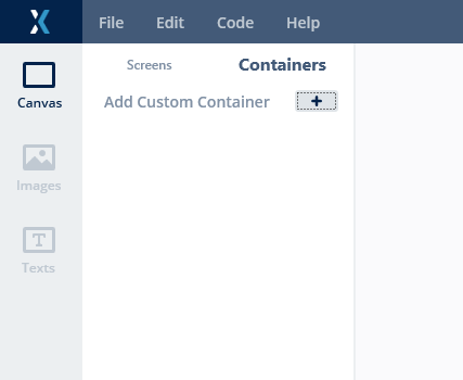

You can create Custom Containers, there you can put all the widgets you want.
Similarly, you can also make those containers visible at runtime.
Unfortunately, each widget/container belongs to only one screen in TouchGFX. That means that you cannot create a common widget for several screens.
