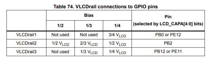

2- at 1/3 bias, the reference manual is supposed to use LCD_VLCD1 and LCD_VLCD2, but STM32CubeMX will now use LCD_VLCD2 and LCD_VLCD3.
Referring to following table from the reference manual, I assume that both reference manual and STM32CubeMX are aligned:
Are we speaking about same things?

2021-03-11 2:37 AM
Hi @HMura.6 ,
Point 2: for 1/3 bias, I confirm that LCD_VLCD1 and LCD_VLCD2 are the ones to use (LCD_VLCD3 should remain grayed in STM32CubeMX).
Please note that a new English version of RM0367 will be available in order to support all required updates.
-Amel
2021-03-14 5:08 PM
Thank you for your answer.
I understand that for a 1/3 bias, I would use port of PB2 and PB12 or PE11.
Thank you very much.
